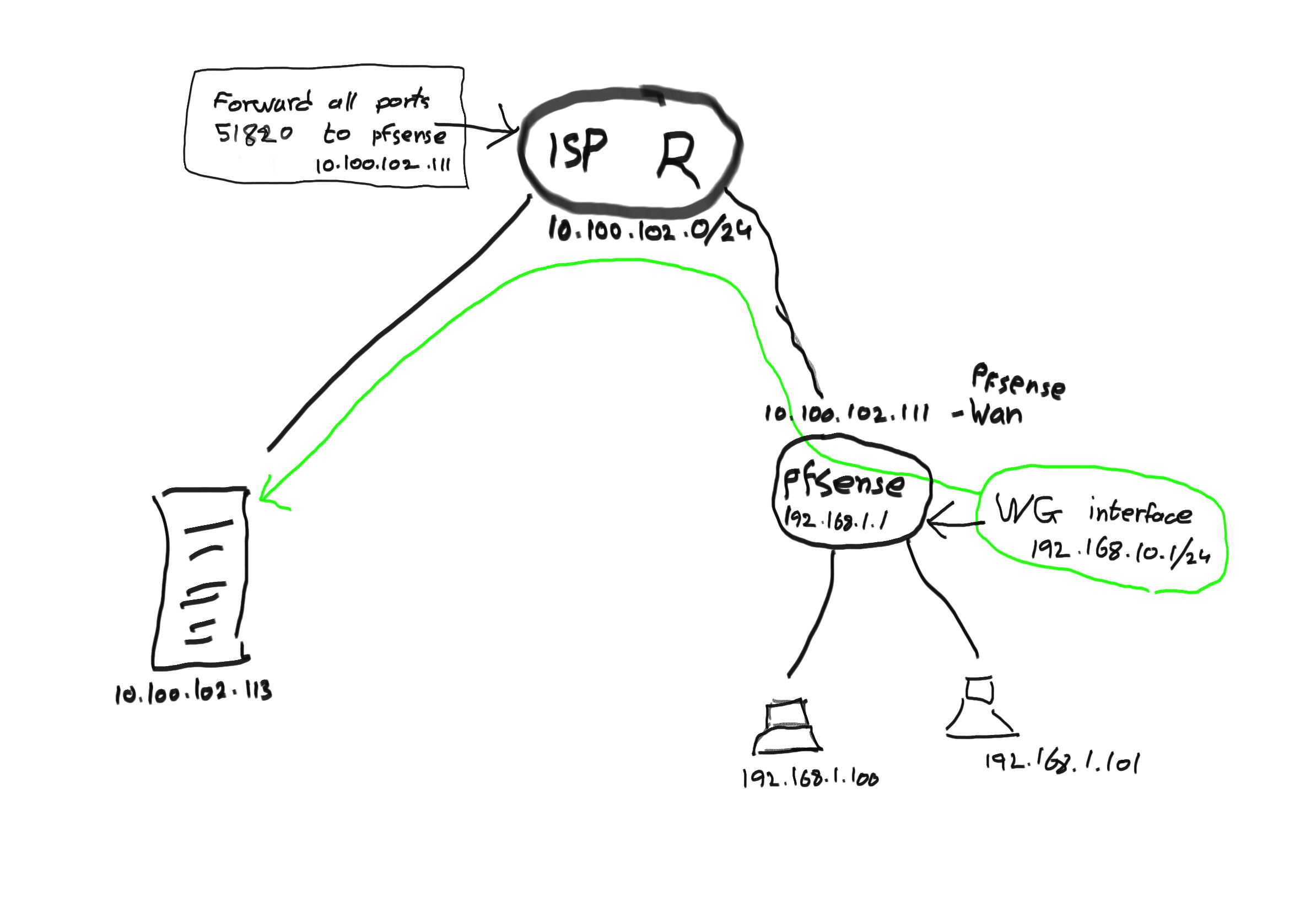

  • Problems accessing remote host over cellular
    538 Views
    For info I resolved this by adding a persistent static route for the PC I wanted to connect to. Network address / Netmask / Gateway address 10.252.30.0 / 255.255.255.0 / the node address of my Wireguard device. Job done, works a treat.
