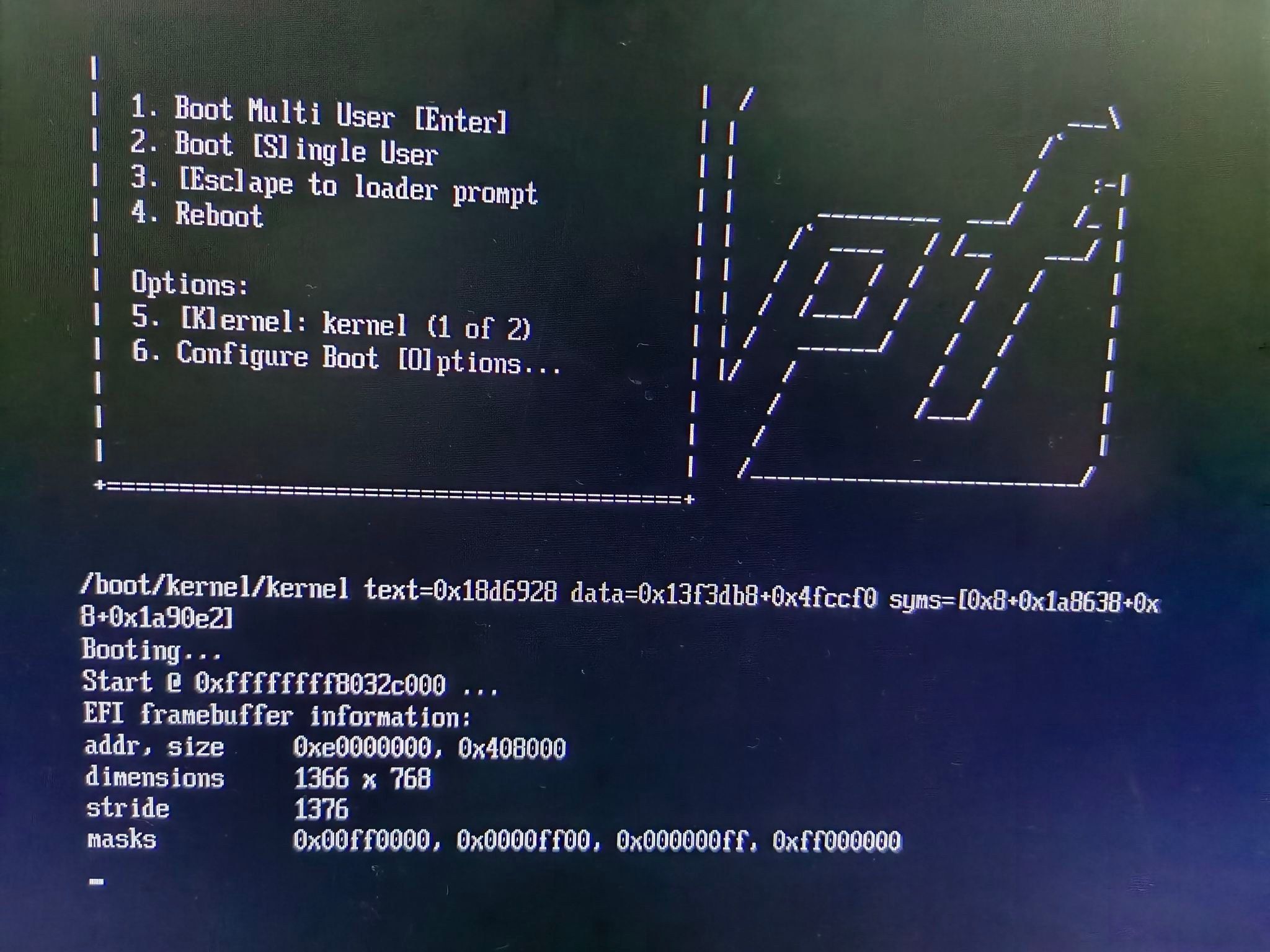

                      Where does it fail booting legacy?
                        marlonbsantos @stephenw10
                        @stephenw10 I tried 2.4.5 p1, and this is my error. Is it Video issue or EFI BOOT?
                          That's still booting EFI, or at least trying to use the EFI console. Does it not boot legacy differently?
