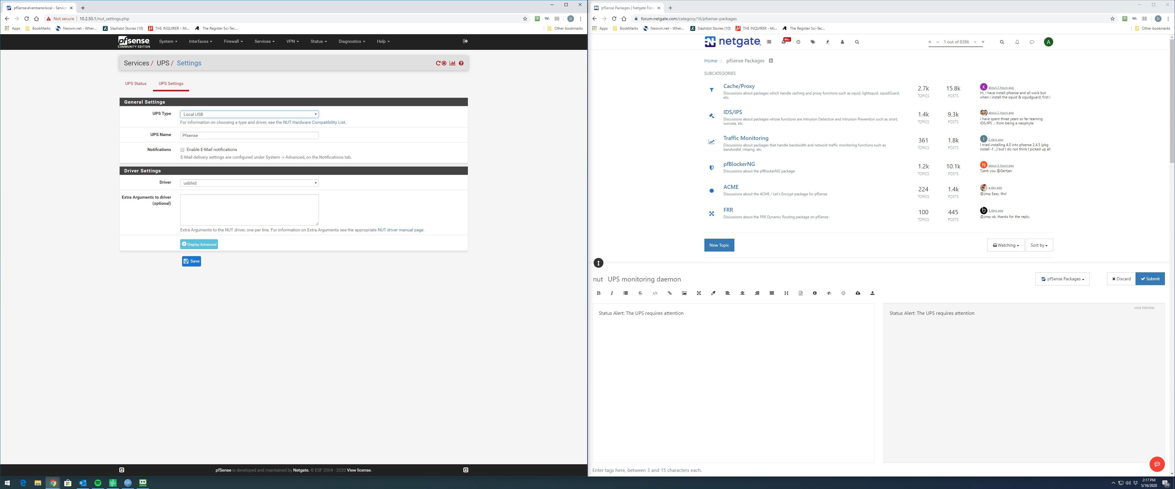

  • nut UPS monitoring daemon
    579 Views
    @aadder Did you get this working? If not does the acpupsd program work? If you want to used nut for this then connect to the system using ssh and check the permissions on the usb device the ups is connected to. That would be in /dev/usb/ directory. The permissions should be crw-rw---- root uucp
