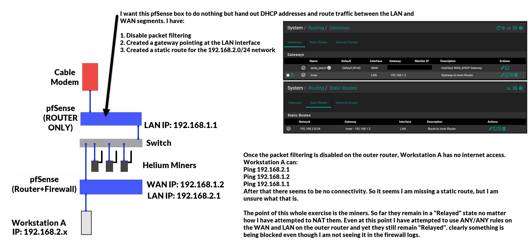

  • pfSense Nebie with a Routing question.
    921 Views
    @phurious those all look like out of state blocks.. they are all R or FA, etc. I don't see any Syn blocks. If you renabled the firewall while it would be expected to see out of state traffic until the devices all recreate sessions with syn and new states are created.
