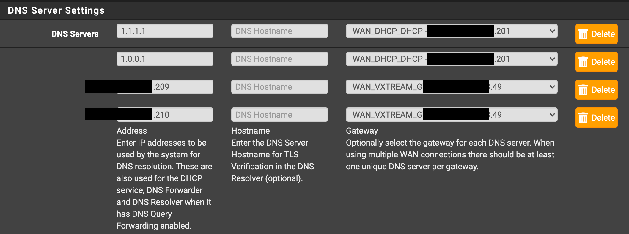

  • Cannot get DDNS working on my Dual WAN failover setup.
    324 Views
    SipriusPTS
    So it was routing those pings to 1.1.1.1 through the wrong GW because of the "dns server" setting on "general setup" for that GW, after changing it to 1.0.0.1, I was able to use the default gateway while doing a ping for that IP from tier 2 GW, as expected. I've wasted like 5 hours digging in this ...
