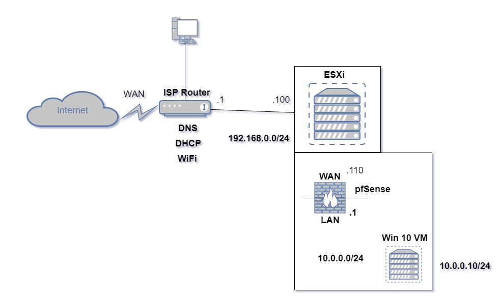

    randomeclipseR
    I'm thinking it may be easier if I replace the ISP router with one I can control more, as I was hoping it wouldn't be as tough as it's being to just present an IP down to the garage and then off I go. Or, maybe throw in a L2 switch and patch it all in and see how that goes :) [image: 1541958858359-home_lab_2.jpg] Cheers.
