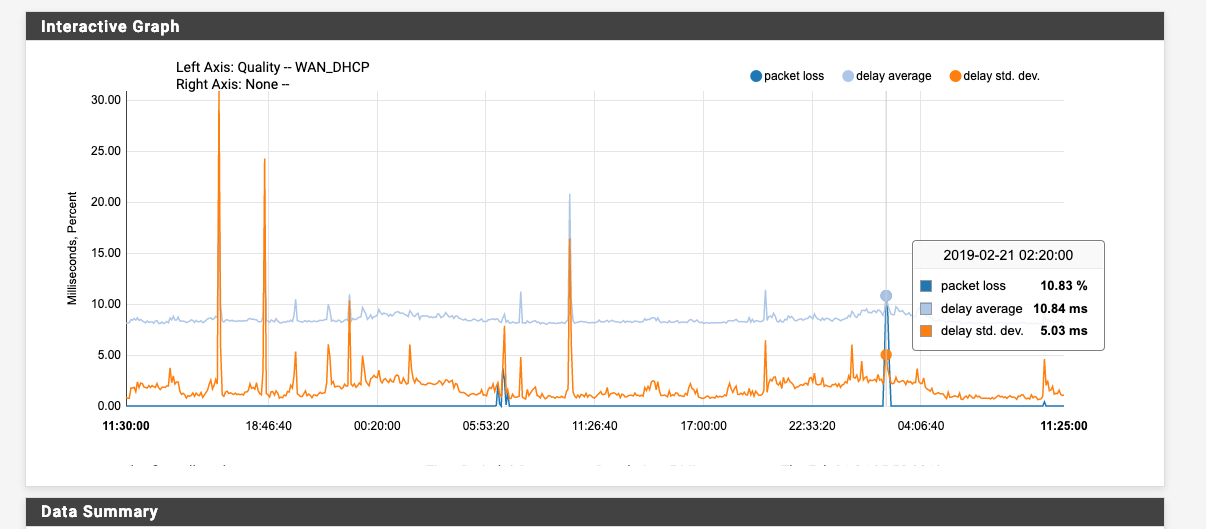

    @vronp said in very strange problem: @kom said in very strange problem: That log doesn't look very good. High latency and packet loss. What type of NICs are you using? As stated, this is an SG-3100, from Netgate. So, I believe they are Intel. The concern I have is not this "event", but the ongoing result after the packet loss and latency appear to have returned to normal levels. I think the next time this happens, after I do what you suggest regarding ping tests, I will disconnect/reconnect the coax cable from the modem and leave the ethernet cable to the pfsense box alone. This appears to be resolved and was apparently due to a faulty modem (Netgear CM600).
