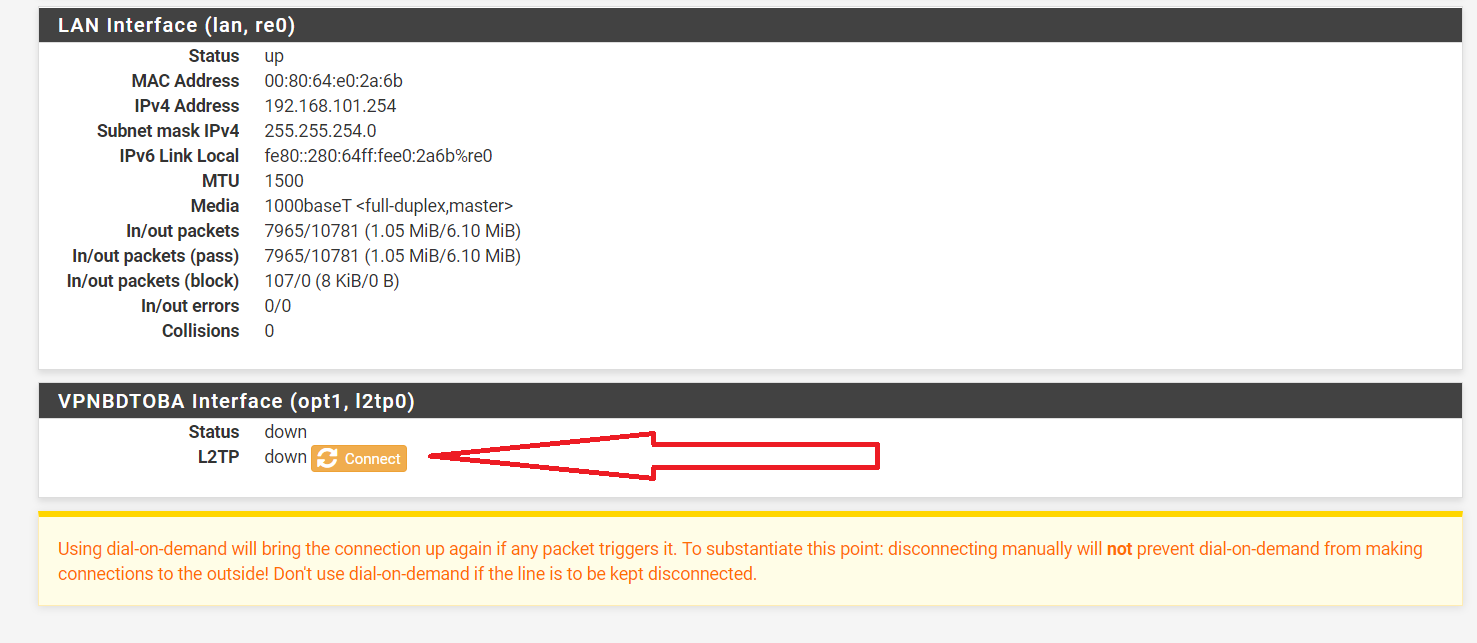

  • How to connect from command line iterface l2tp
    198 Views
    This is solution https://forum.netgate.com/topic/40344/how-to-bring-interface-up-from-pfsense-commandline/5
