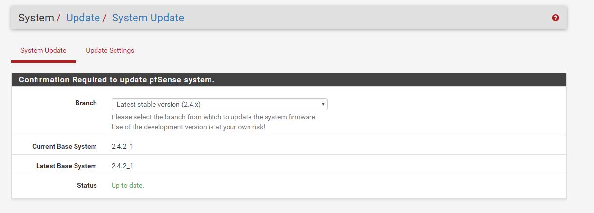

  • Pfsense update not seeing latest version
    518 Views
    G
    I was able to perform the update to 2.4.3_1 Seems it was a DNS setting. Once I corrected this setting pfsense saw the latest update. -Gary
