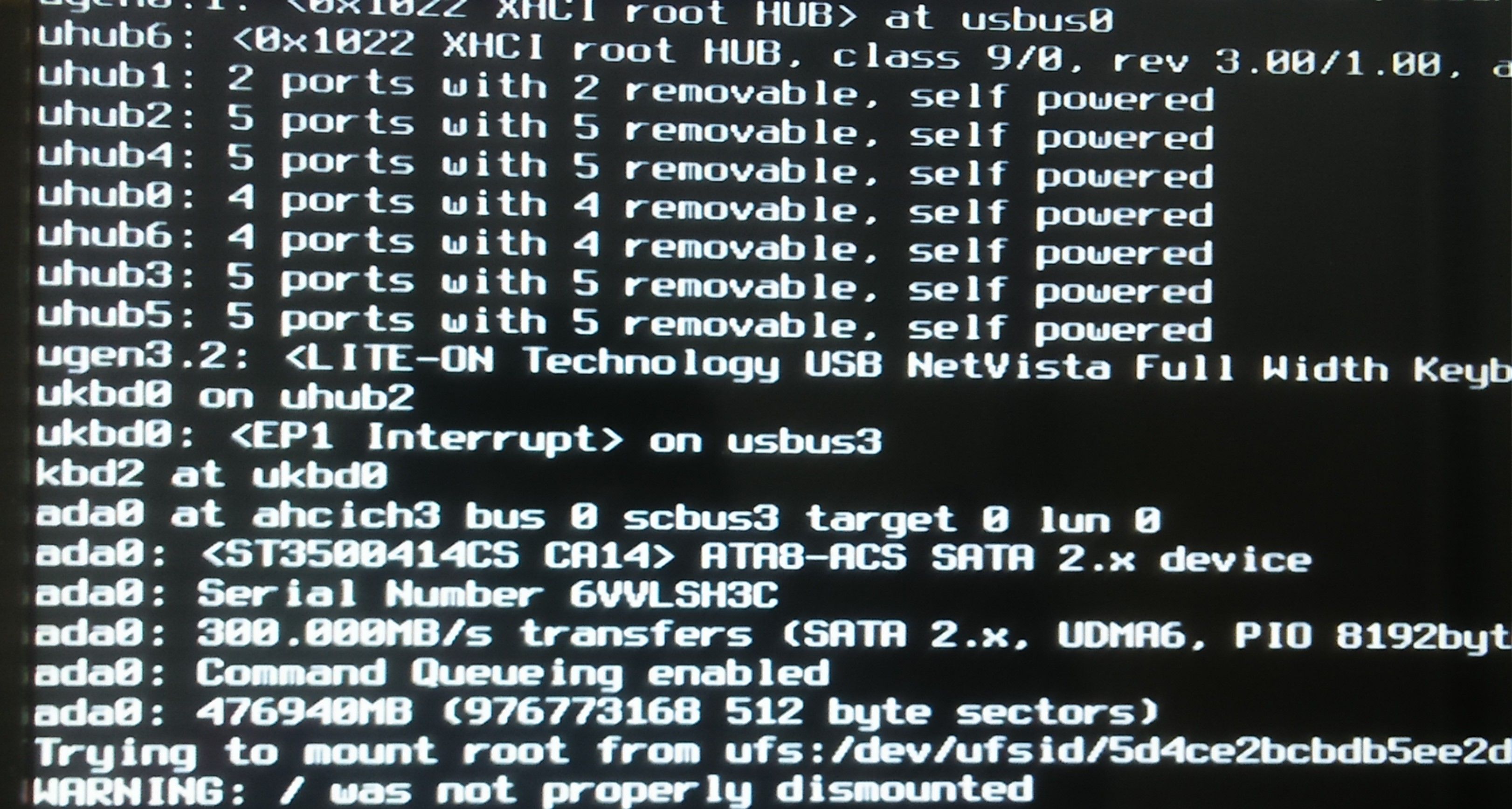

  • giant locked - atkbd0
    giant locked
    KOMK
    No idea at this point. I would check for firmware/BIOS updates for your board if you haven't already done so. Also, you might want to check out pfSense 2.5-devel which is based on FreeBSD 12 I believe. Not for production use, but seems to work pretty well. https://www.pfsense.org/snapshots/
