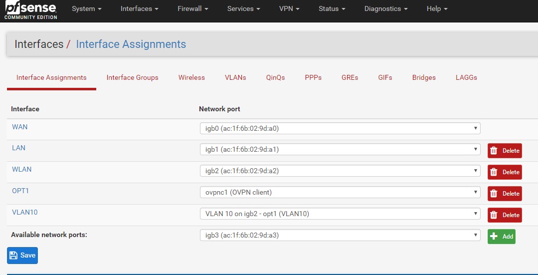

  • Add NIC as extra LAN-port?
    563 Views
    @derelict said in Add NIC as extra LAN-port?: Get a switch. Leave igb3 available for use as a router port. If you insist on doing that look at bridging igb1 and igb3 into a bridge and use the bridge for LAN. I got a 5-port switch today which is in LAN but it's full, and I want to buy a Ubiquiti PoE switch 8-60W (about $100) but I only need 1 port so therefore it's not really negotiable to buy one just for I need one extra port lol So I thought if it's easy to use it as a LAN-port in the meantime...
