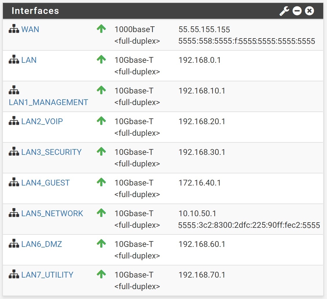

    its a good obfuscation then - looks like actual screen shot! Better to mention you obfuscated or use documented example networks and mention that ;) 192.0.2/24 198.51.100/24 203.0.113/24 2001:DB8::/32 Just saying ;) You would be surprised at some of the stuff you see around here people doing for real ;) Or just block out part of the actual address so its clear is obfuscation..
