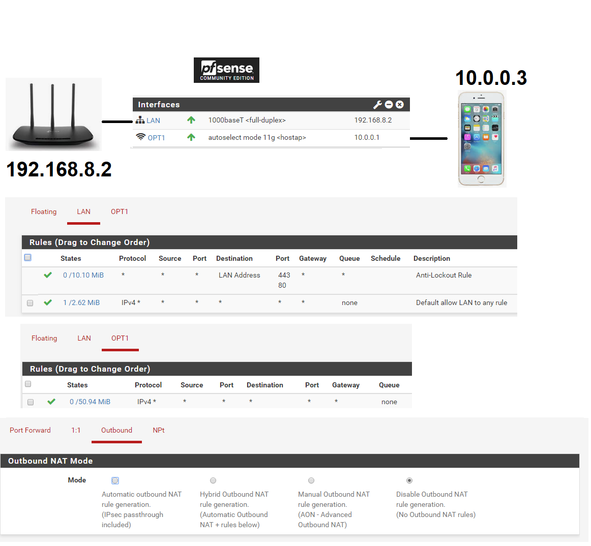

  • WiFi -> Pf -> Router -> WAN problem
    DHCP and DNS dhcp nat configuration
