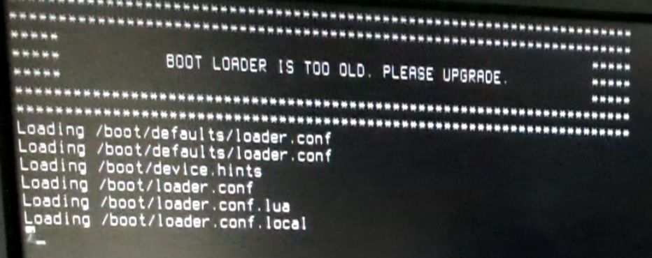

      Upgraded from 2.7.2 to 2.8.0 this evening. I kept getting errors when uninstalling packages (saying another instance was already running), since I like to follow best practices and uninstall all packages prior to the upgrade. Welp. So after a pre-upgrade config backup, I pulled the trigger.
      I watched the log in the console, and there were hundreds of errors where it couldn't find packages (.gzip or something), but it kept on chugging along.
      After a second reboot, the version in the console welcomed me with 2.8.0 and it loaded right up. Every boot I see a: "BOOT LOADER IS TOO OLD. PLEASE UPGRADE." warning flash on the screen for about 1/8 of a second. I recorded a video and took a screenshot from the video:
      What is the cause of this error?
      The system is stable now, but a big part of me simply wants to take a new 2.8.0 config backup and perform a clean, full install of 2.8.0 and restore the config.
      Thanks for any help and answers.

          Gertjan @Finger79
          @Finger79 said in "Boot loader is too old. Please upgrade" in console after upgrading to 2.8.0:
          The files you listed are small text files.
          Can you show them ?
          Or, (It's Friday afternoon, so allowed) console or SSH into your pfSense, go option 8, and use these commands
          touch /boot/defaults/loader.conf
          touch /boot/device.hints
          touch /boot/loader.conf
          etc.
          and now all files will have a 'today' = now time stamp, so not old anymore.

            • jimpJ Offline
              The upgrade process tries to update the boot loader but there are some edge cases where it can't do so properly/fully.
              One thing to check is if you have multiple disks in the system. If there are multiple disks and pfSense is installed on both of them it could be using the boot loader from one disk but the kernel from a different disk.
              The fix in that case is to wipe the old/unused disk and/or make sure the EFI/BIOS is booting from the correct disk.
              https://docs.netgate.com/pfsense/en/latest/troubleshooting/multiple-disks.html
              You can manually update the loader as well but doing so varies based on your install specifics. For example if it's GPT or MBR, BIOS or EFI, if it has an older or newer style EFI partition, and more.

                      • F Offline
                        Finger79 @jimp
                        @jimp said in "Boot loader is too old. Please upgrade" in console after upgrading to 2.8.0:
                        Just one disk, an SSD. This is a simple baremetal install. Pretty sure it's GPT and EFI. Secure boot is disabled until FreeBSD supports it or pfSense rebases off Linux.
                        Only thing I can think of is I'm using GELI for FDE, but I don't believe it was a problem upgrading from 2.6.x to 2.7.0 and then to 2.7.1 and 2.7.2.
                          That's almost certainly it. The code to update the bootloader is new, it wouldn't have run at previous updates.

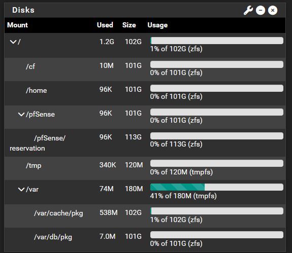

                                    Do either of these help answer your question?
                                      Yes, that the disks still appear as adaX but one partition is different. What does gpart list show?
