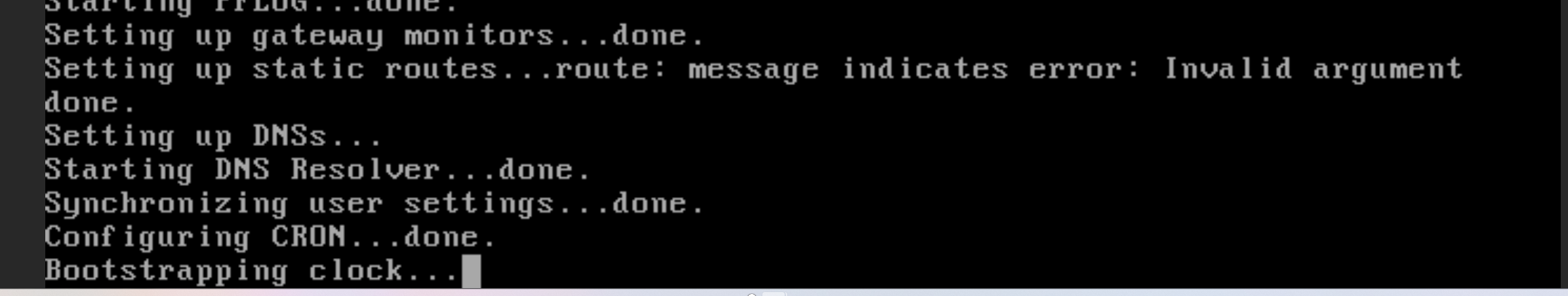

  • Setup static routes on startup fail
    112 Views
    @manusch Awesome!

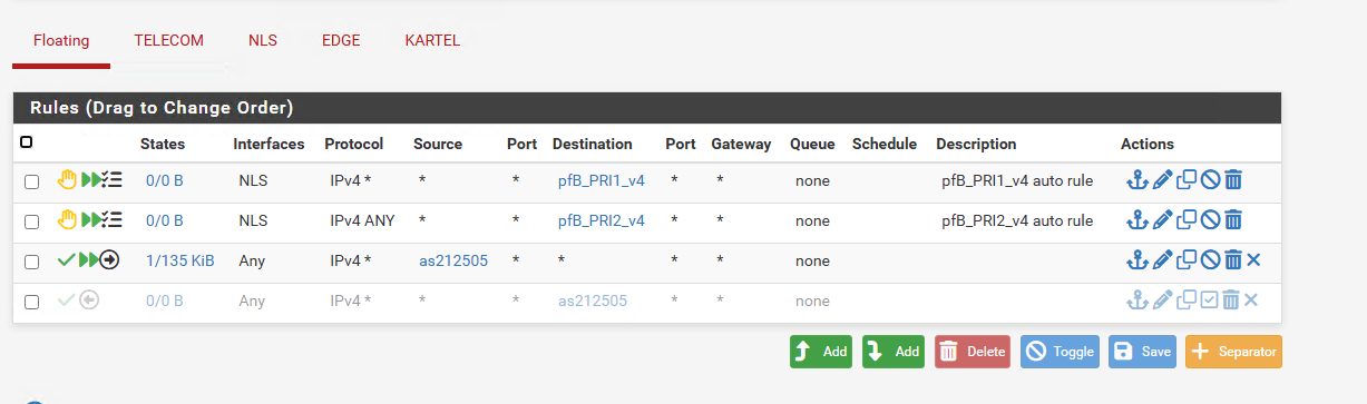

    @SteveITS Thank you very much, this was the nudge I needed! I have non VPN hosts on various VLAN interfaces so I created this Floating firewall rule with an Invert match to alias: RFC1918 and it appears to have resolved the issue. Action: Pass Apply the action immediately on match: Check Interface: Any Direction: In Address Family: IPv4 Protocol: Any Gateway: ATT Defaults for the other settings Is this acceptable or should I have went about this differently? [image: 1760906785264-fc103cab-f97f-4140-a920-11e1d659cb57-image-resized.png]

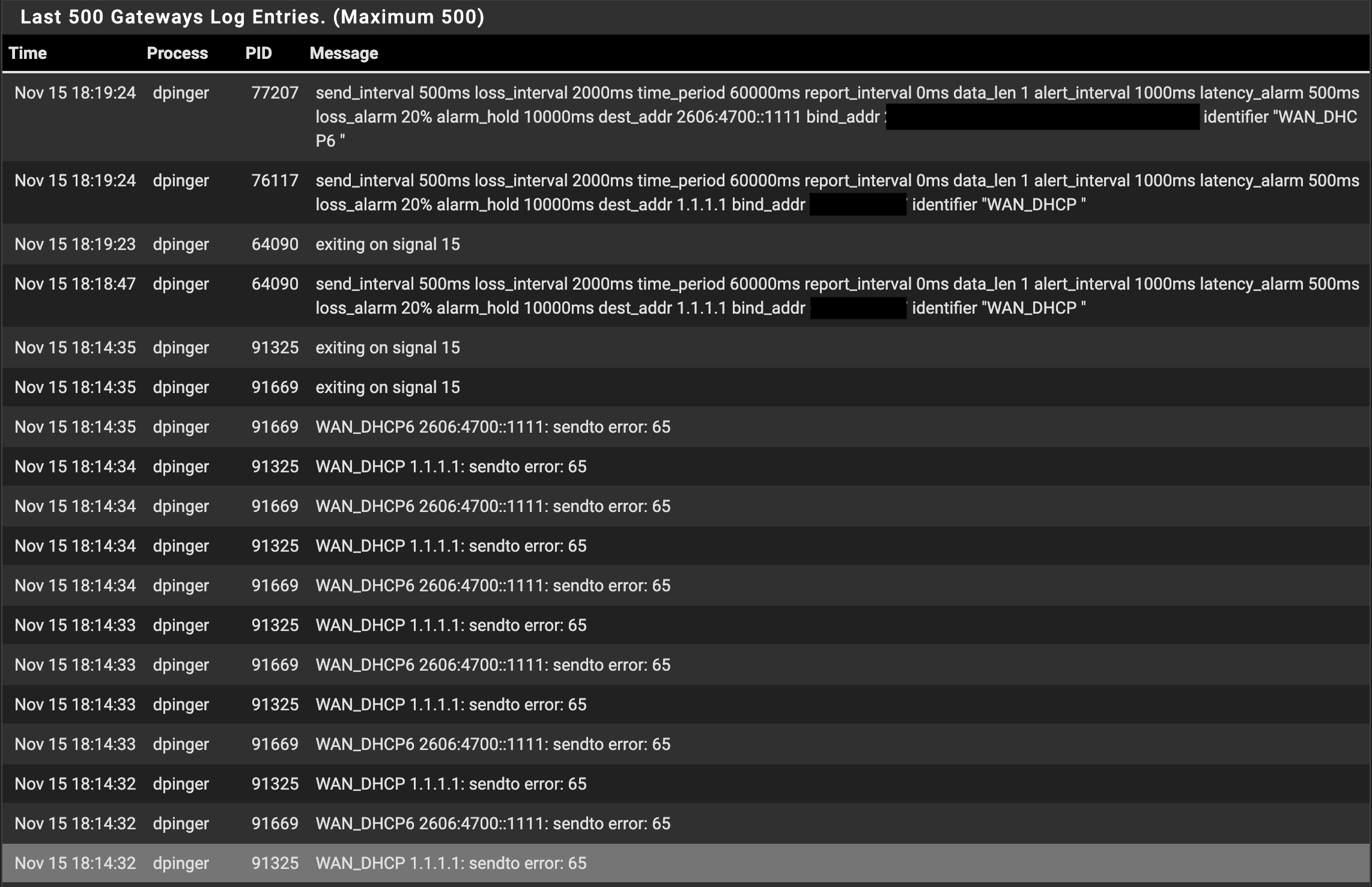

  • Gateway Monitoring Daemon (dpinger) issues resolved
    321 Views
    GPinzoneG
    @SteveITS I should have added that step. Disabling the action allows the service to keep monitoring without causing a catastrophic failure.
