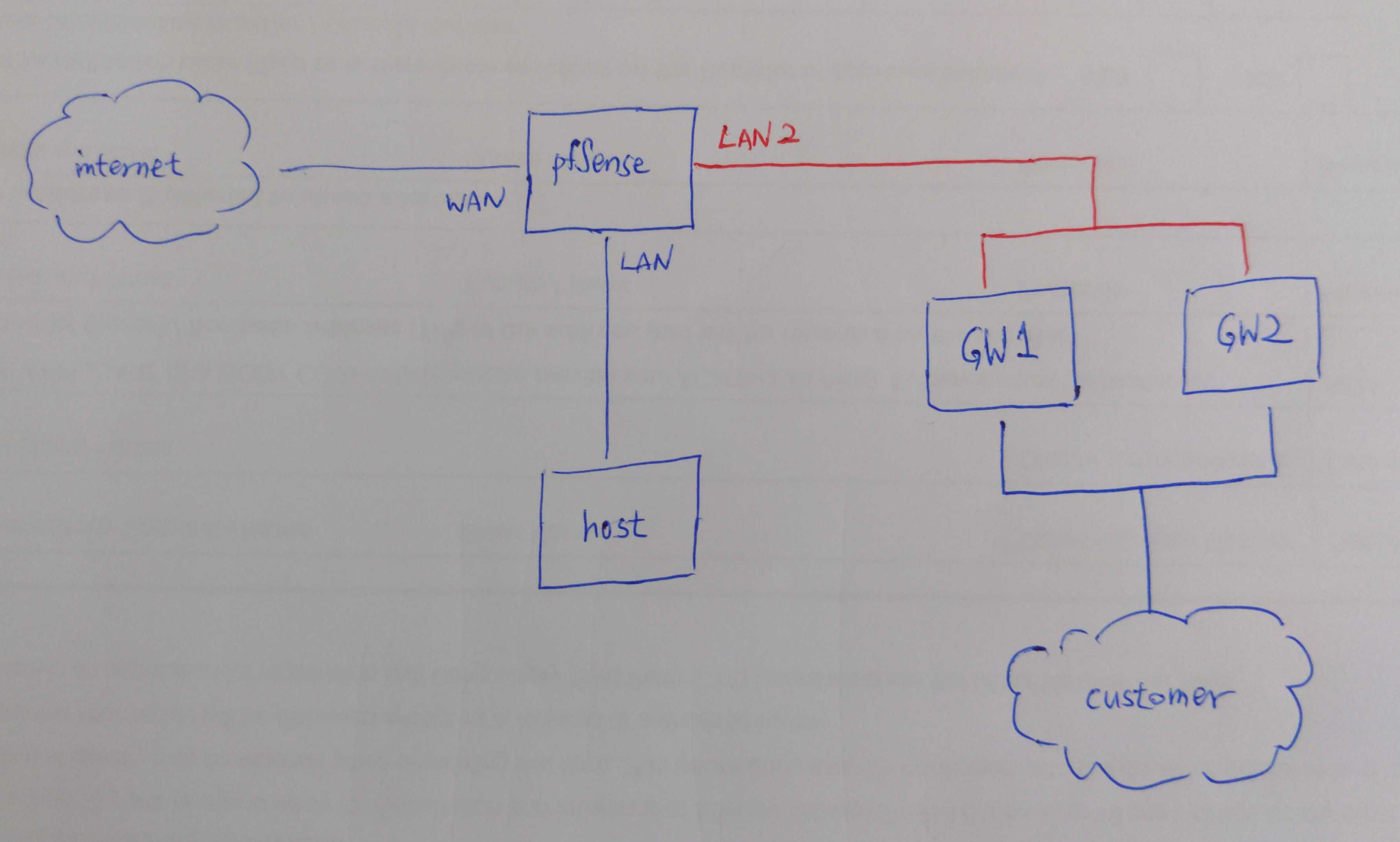

  • Failover GW for non-WAN interface
    12
    @eoin Yes, this is why I suggested to do it with policy routing.
