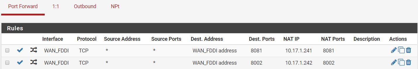

    I would suggest you troubleshoot the port forward like you would any other https://docs.netgate.com/pfsense/en/latest/nat/port-forward-troubleshooting.html But here I just setup your exact rule.. And works just fine. [image: 1570788414936-otherport.jpg] Also!!!! I would not suggest you open remote desktop to the public, even if using a different port.. If you want to rdp to your machines from the outside - vpn would be the more secure option. At a min you should lock it down to only known source IP that you would be using. I had this open for like 10 seconds, just long enough to test it and show you that can work.. Not that its a good idea to ever do such a thing. You understand that windows remote desktop has had multiple security issues, has been all over the news as of late with remote access issues. https://securingtomorrow.mcafee.com/other-blogs/mcafee-labs/rdp-security-explained/

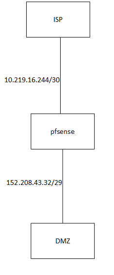

    @joregartinez You can use it just like that I think with the /29 configured on your DMZ interface. In that case, you would probably want to disable NAT for it (enter hybrid NAT mode and put a NO NAT rule for the /29 there.) Binding services on the firewall itself (Like a VPN Server) should be able to be told to listen on the DMZ address, but I can think of things the system is going to do that will break that, like the host route to the other side. You might need a VIP on the WAN for that. Outbound NAT for connections from the firewall itself should be able to be told to use the DMZ address as well using manual outbound NAT but I have never tried that. Seems it should work just fine but you might hit some kind of route-to weirdness I'm not thinking of. But if you have a VIP on the WAN for service binding you might as well just use that. It is generally a bad idea (as in it breaks things) to NAT connections from the firewall itself and from the WAN address. You will want to do exactly that, though. If you do put a VIP on the WAN make it a /32. Note that hosts on the DMZ will not be able to access that VIP because they will not know it is not on their local subnet.
