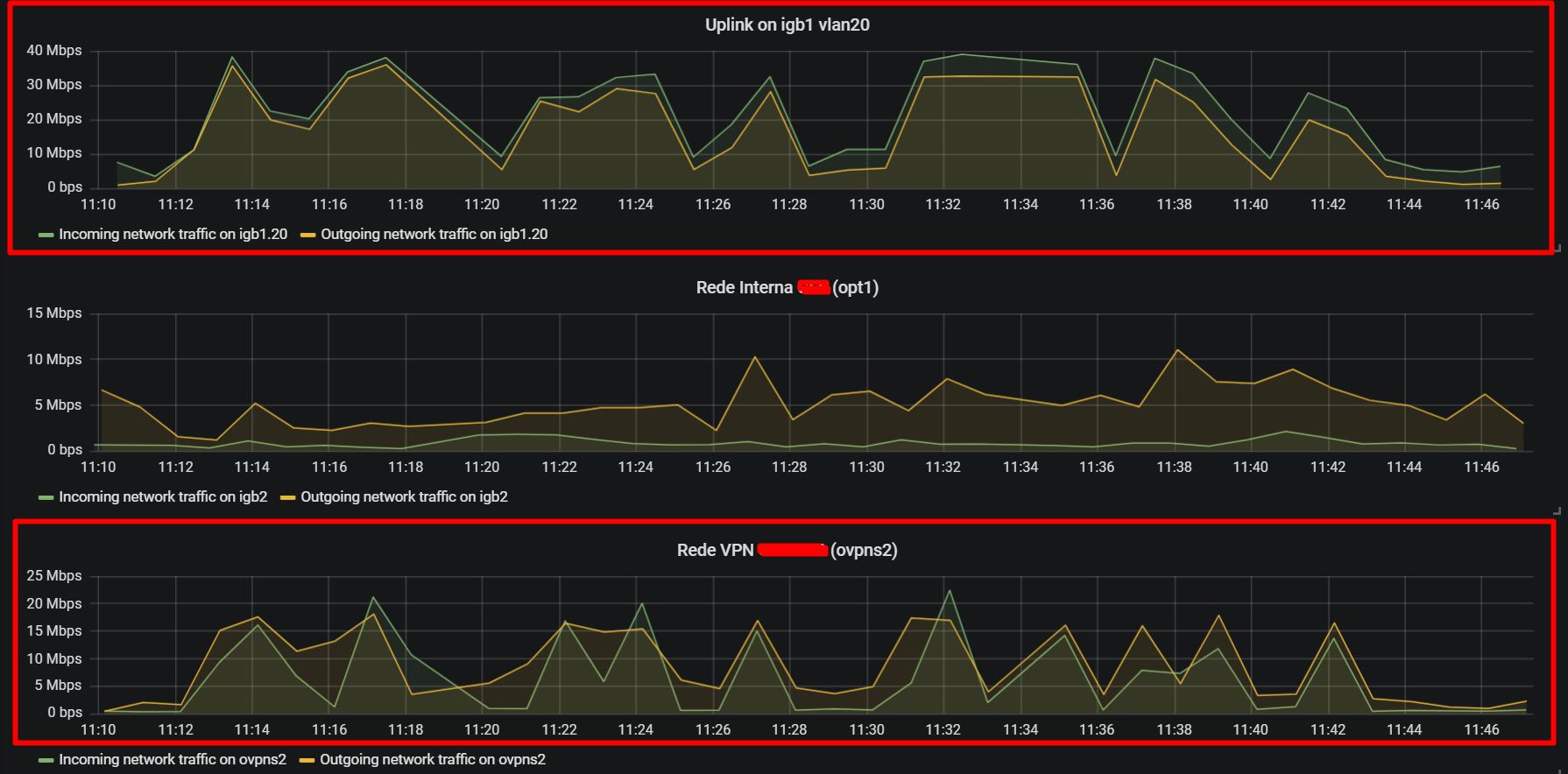

• [SOLVED] Loss of internet speed while on VPN from site to site
    629 Views
    SipriusPTS
    So I had changed IPv4 remote network at remote side, just to route my primary side network, to avoid this situation. I have also tested crypto accelerators in both sides but didnt had any change.

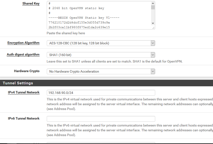

  • packet HMAC authentication failed on peer-to-peer (shared key)
    @jimp said in packet HMAC authentication failed on peer-to-peer (shared key): Are you certain both systems are using the exact same shared key? That's the easiest way to get that error. I'm waiting to get the file from the client, but last time I checked (2 weeks ago when we first brought it online) they were the same. EDIT: Checked and both are identical.
