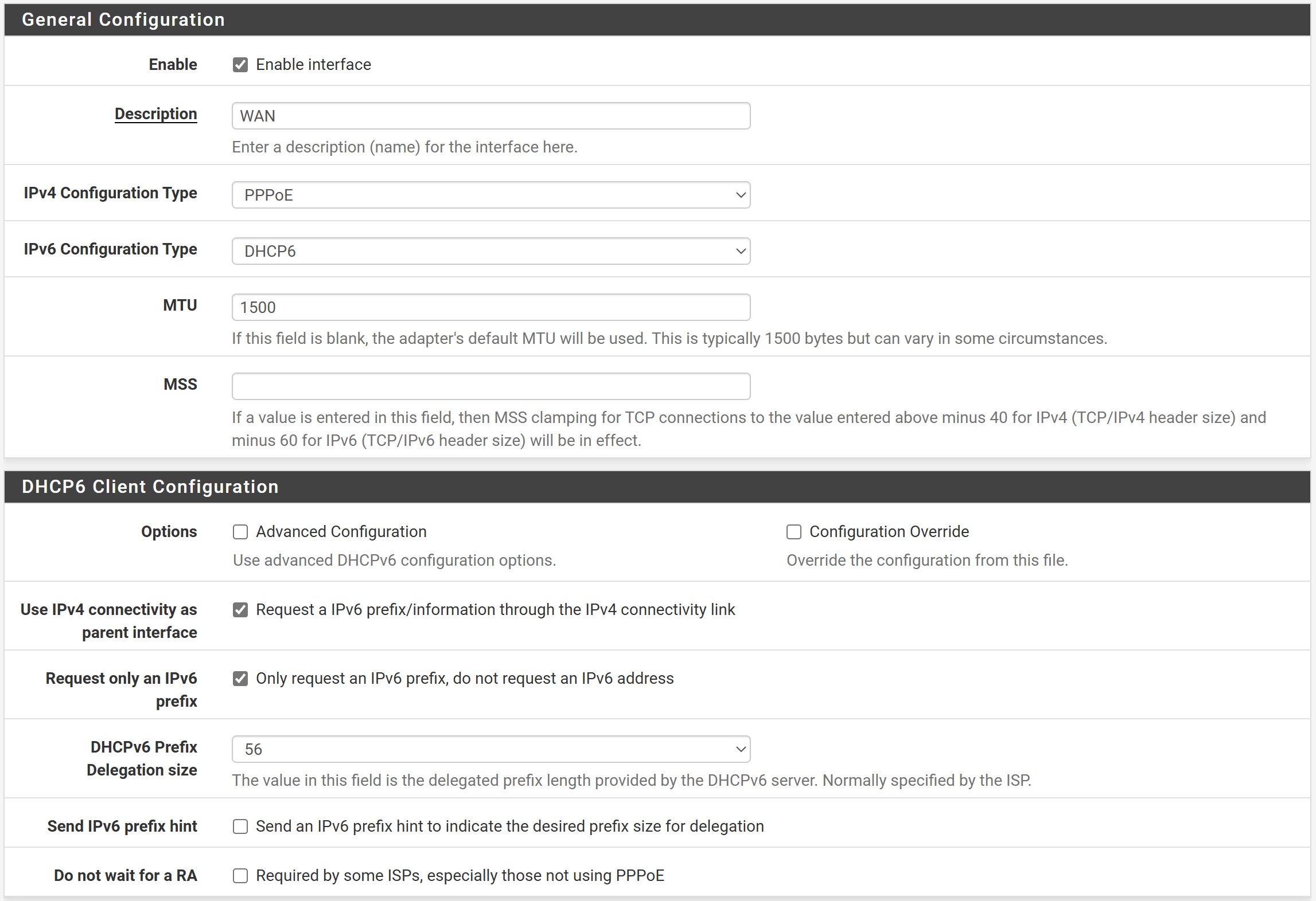

  • BT Full Fibre only partially functioning via pfSense Router
    27
    27 Posts
    Hmm, how are the clients configured for IPv6?
