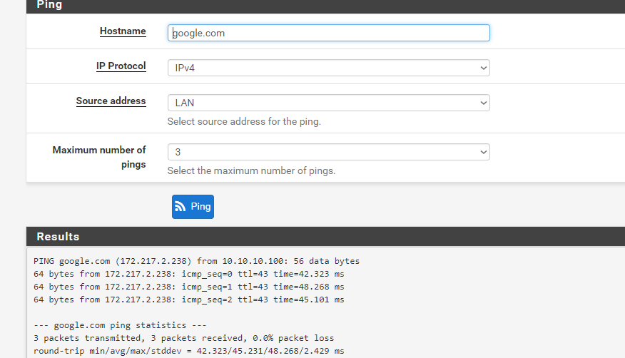

  • No internet Connection. LAN side.
    I would suspect some hardware off loading not playing nicely. Things can get weird when you are testing from the host itself as traffic does not actually enter/leave the NIC. It not subject to the same path as traffic from external clients. Steve
