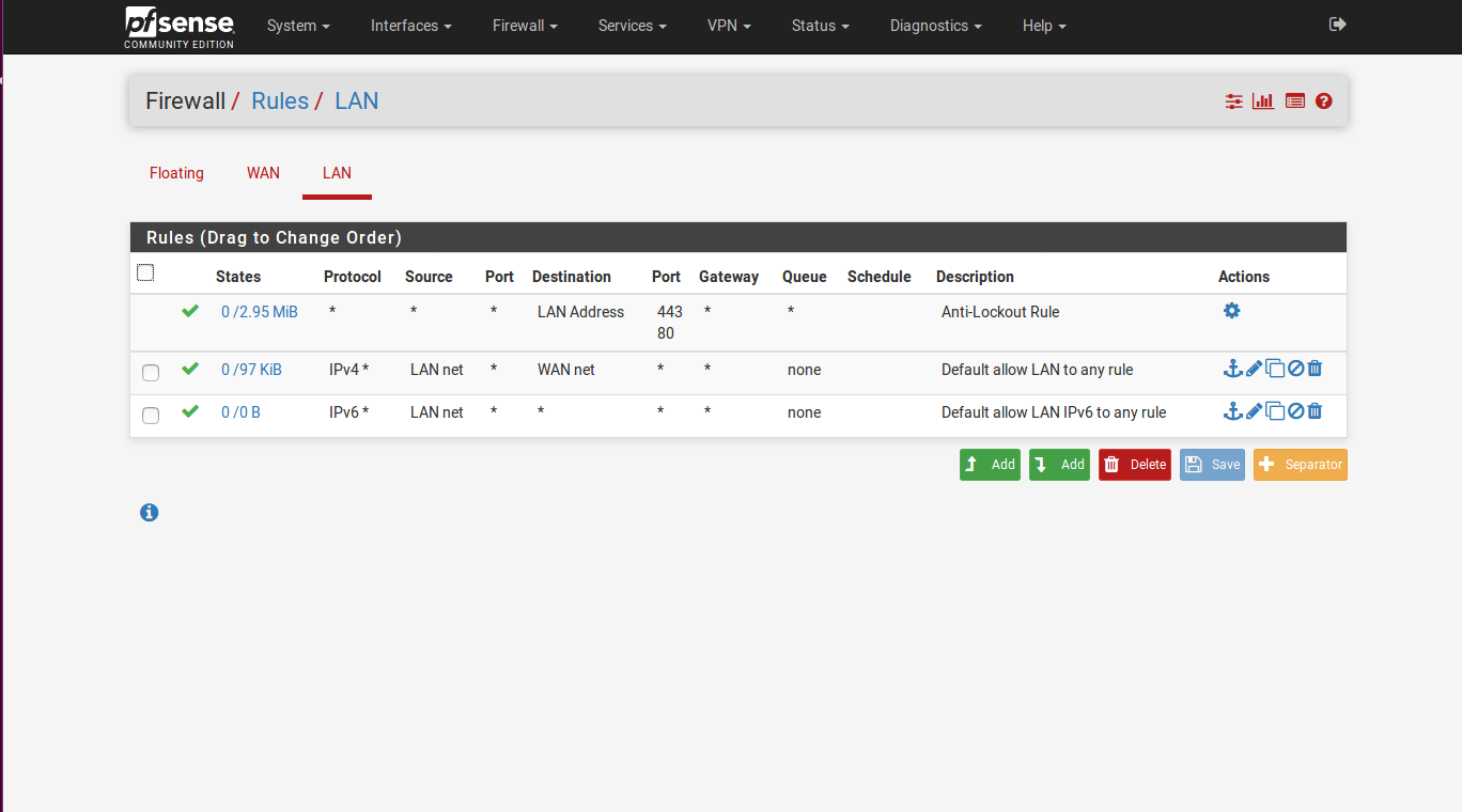

    Thanks for the reply sorry I wasn’t clear the other config was for a PF sense box that I have that is already up and running I was hoping I could put the config on the system that I couldn’t get to access the Internet and try it that way even with the config from the working PF sense box it still was not able to connect to the Internet at this point I’m at a loss I reset the config several times the only thing that I haven’t tried yet is downloading a fresh copy Any other ideas? What would a good firewall entry look like
