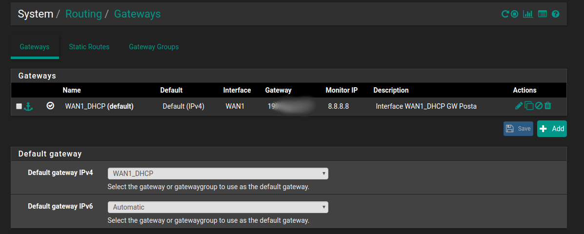

  • 2.4.4p1 Routing Error
    @gil said in 2.4.4p1 Routing Error: I then reloaded the pre-saved config file This doesn't really help this time, but next time it might be informational to save the non-working config file first, and compare it to the saved one.
