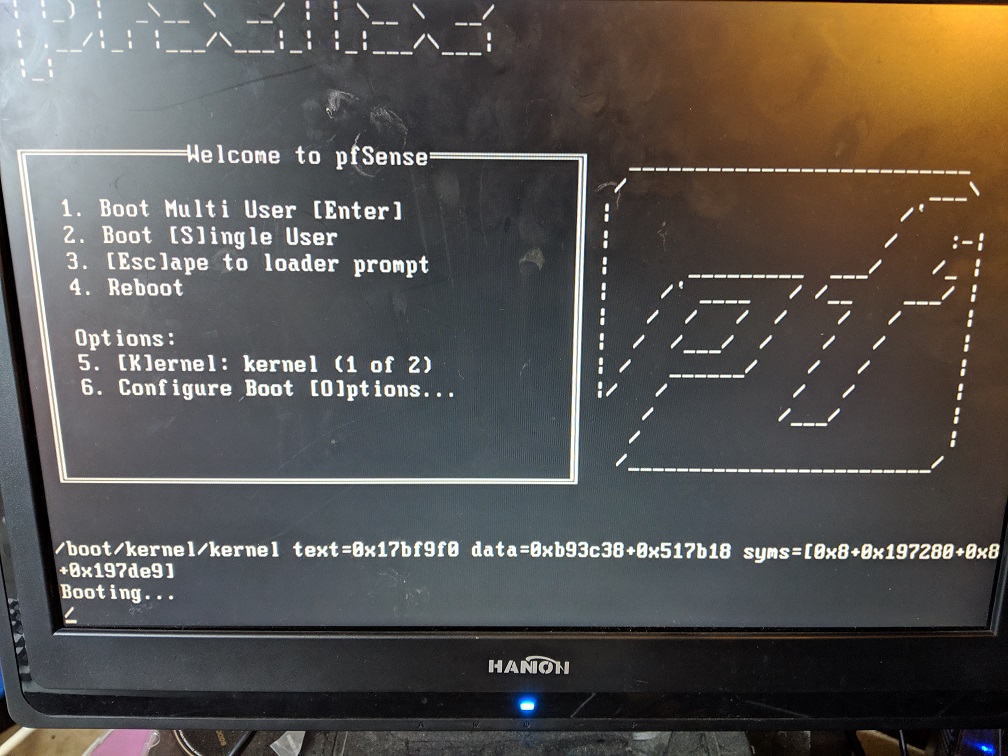

    @marc1701 hey marc, I am so happy to find you as I have the same exact J1900 celeron I just wanted to chime in, I was also experiencing the same issue as you, it would get stuck at boot when going from 2.3x to 2.4x, I followed your instructions and chose kernel.old (option 5) twice, the second time it booted in to 2.4.4-RELEASE , I cannot express my gratitude for your words on this forum you don't understand how much headache you have saved me, thank you so much!
