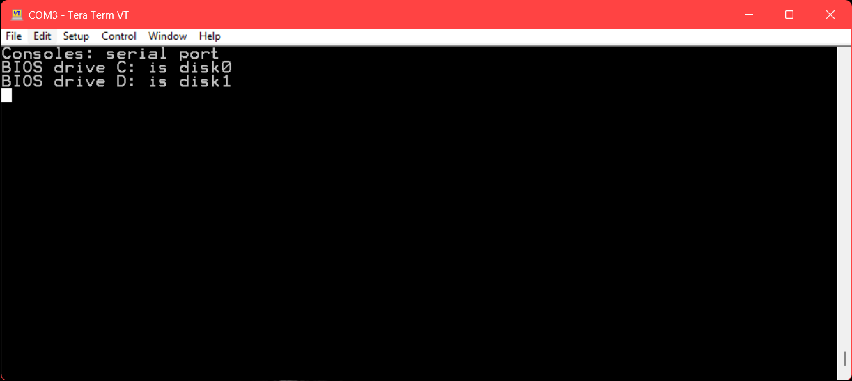

  • How to get Marvell prompt?
    383 Views
    It waits for 3 seconds and shows a countdown: TIM-1.0 WTMI-devel-1.0.0-1115f12 WTMI: system early-init SVC REV: 5, CPU VDD voltage: 1.237V NOTICE: Booting Trusted Firmware NOTICE: BL1: v1.5(release):ROGUE2-01.00.00.01-cpu1_2G-0-g06b570a8d (Marvell-release-1.3.0) NOTICE: BL1: Built : 14:34:11, Feb 7 2020 NOTICE: BL1: Booting BL2 NOTICE: BL2: v1.5(release):ROGUE2-01.00.00.01-cpu1_2G-0-g06b570a8d (Marvell-release-1.3.0) NOTICE: BL2: Built : 14:34:13, Feb 7 2020 NOTICE: BL1: Booting BL31 NOTICE: BL31: v1.5(release):ROGUE2-01.00.00.01-cpu1_2G-0-g06b570a8d (Marvell-release-1.3.0) NOTICE: BL31: Built : 14 U-Boot 2018.03-devel-1.2.0ROGUE2-01.00.00.02+ (Feb 07 2020 - 14:33:22 -0500) Model: Silicom Rogue-2 CPU 1200 [MHz] L2 800 [MHz] TClock 200 [MHz] DDR 750 [MHz] DRAM: 3.4 GiB Comphy chip #0: Comphy-0: SGMII1 3.125 Gbps Comphy-1: PEX0 2.5 Gbps Comphy-2: SATA0 6 Gbps PCIE-0: Link down MMC: sdhci@d8000: 0 Loading Environment from SPI Flash... mvebu_spi_ofdata_to_platdata: ofdata clock 200000000, frequency 20000000 SF: Detected w25q32bv with page size 256 Bytes, erase size 4 KiB, total 4 MiB OK Model: Silicom Rogue-2 Net: eth0: neta@30000, eth1: neta@40000 [PRIME] Hit any key to stop autoboot: 0 Marvell>> Pressing space (or any key) should stop the boot. If it doesn't then perhaps your terminal setup is not sending it correctly. Steve

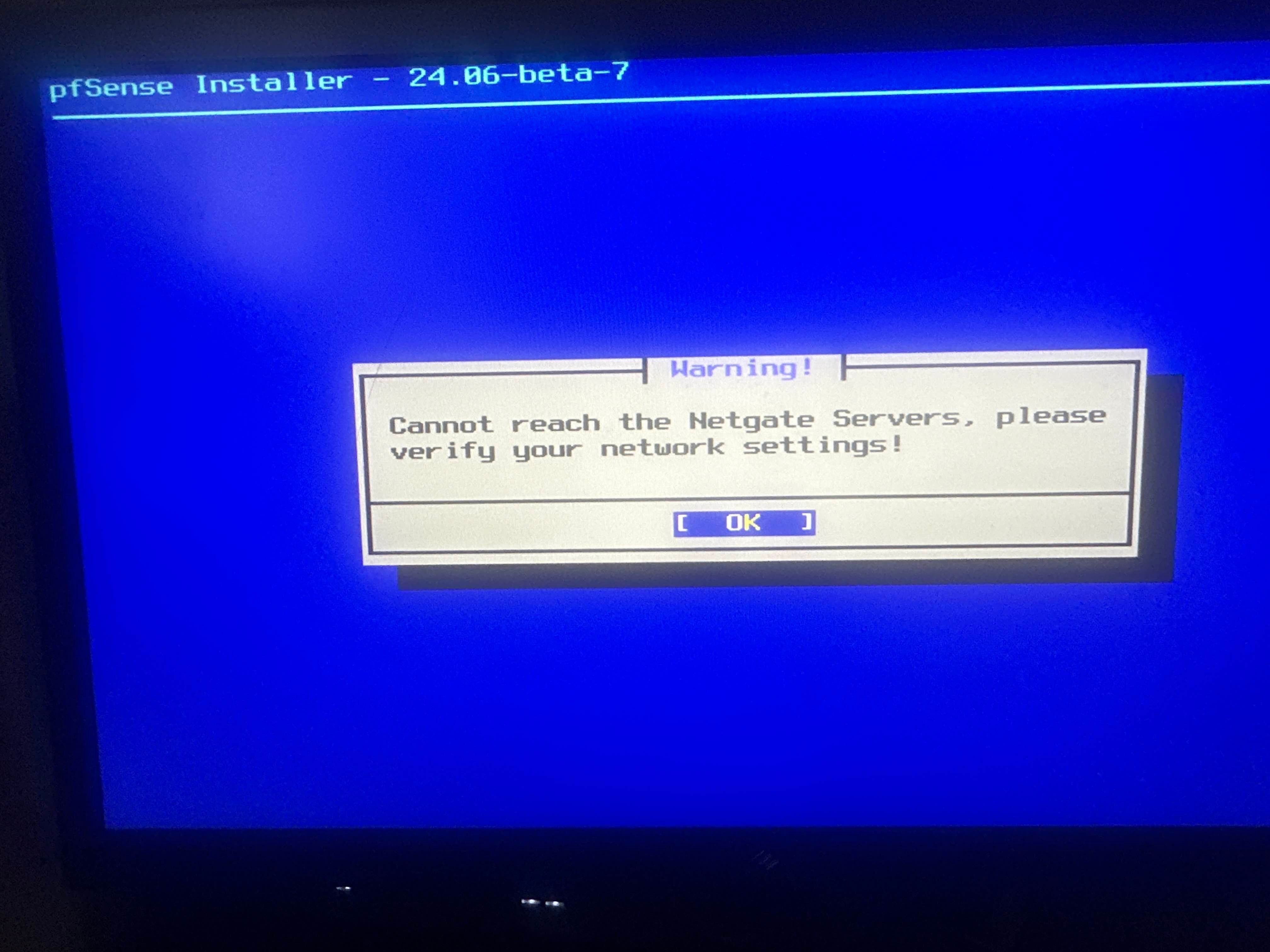

  • Cannot connect to netgate servers during fresh pfsense install
    47
    2 Votes
    47 Posts
    18k Views
    F
    After a lot of struggle this was my solution; It seems a static ip in the 192.168.1.x range is restricted so I changed the ip address of my isp router to 192.168.13.x. Powered off my pfsense1100 booted with usb (only the righter slot works) and pressed the [y] button a couple of times to prevent autoboot. Then I started the ‘recovery’ instead of ‘install’. And in the recovery I only opened the shell to ping a website and confirmed that my internetconnection was working. Then I typed exit to start with the install. And everything worked instantly. During the install you get at 3 moments the feeling that everything is stuck. Especially during the last stage, -the real install- just wait for like 10 minutes.

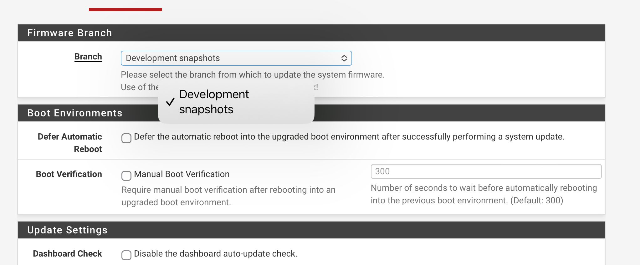

  • PfSense packages can not be updated and if I try I get a crash report
    148 Views
    Now I did the following: env ASSUME_ALWAYS_YES=yes pkg-static bootstrap -f After that I went to System Update and it showed that I have a new Version available. Before that it always showed that 2.7.0 is the latest version for PfSense. So I updated from 2.7.0 to the new stable version 2.7.2 After it upgraded and rebooted (it felt like it took much longer than usual) But now it seems to work somehow. The package manager shows items and the crash report does not show up anymore. I think the issue is no more. (I hope)

  • Package manager 23.05.1-RELEASE is empty
    133 Views
    Make sure the update repo branch is set the 23.05.1 still. At the command line run: pkg-static -d update See what errors are shown. Steve

  • pfSense Cannot reach the netgate servers during fresh install
    900 Views
    When the installer fails it will drop you at a prompt but the network settings will still be in place. You can try to ping (or do any other tests) from there.
