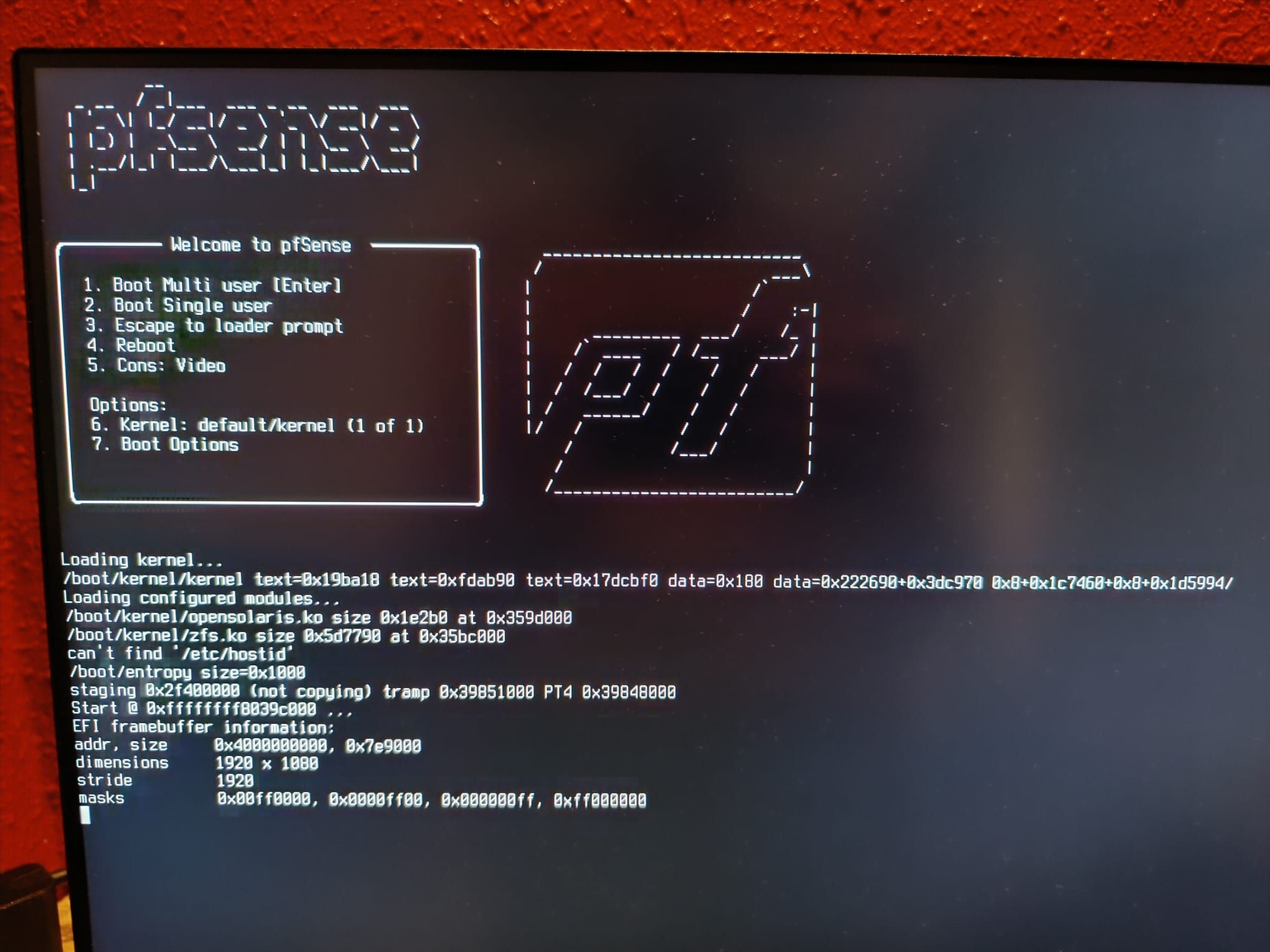

  • Unavoidable freeze after first reboot
    102 Views
