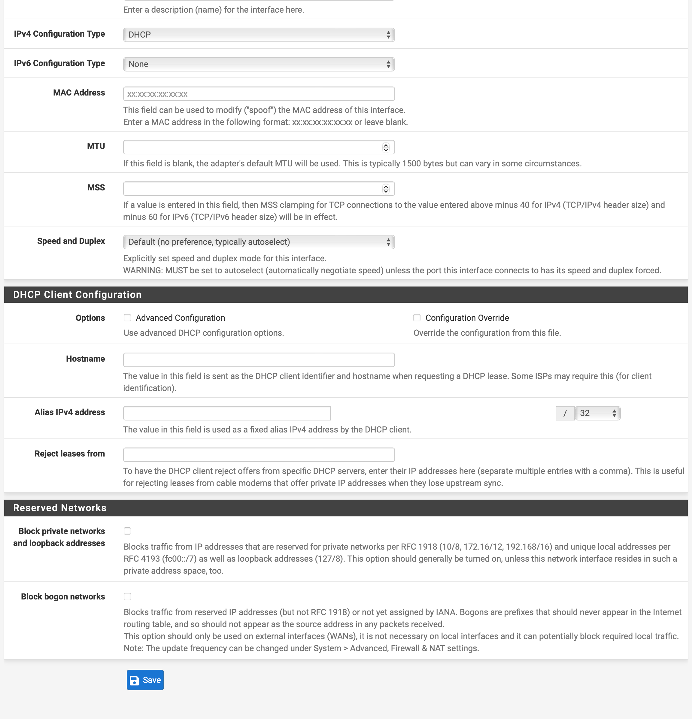

  • Upgrading SG-1100 to SG-2100
    You can have the WAN as DHCP and add additional static IPs as VIPs. You can't have multiple DHCP clients on the same interface/subnet. Steve
