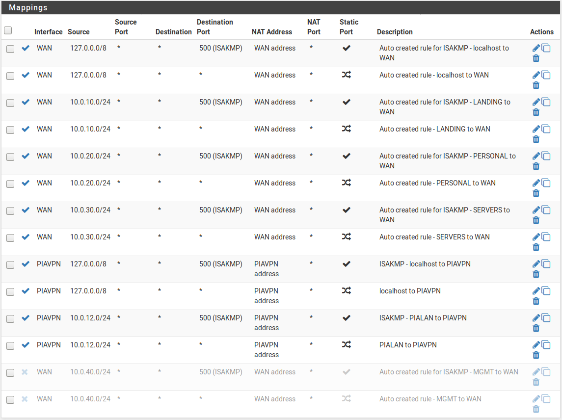

    You have to outbound NAT on the interface you are forwarding the traffic out of to the target. That way the source address appears to be from an address on the target's local subnet so reply traffic doesn't get forwarded by the target server to its default gateway.
    If you were port forwarding TCP port 80 to LAN host 192.168.1.100 the NAT would look like this:
    Firewall > NAT, Outbound
    Select hybrid if not already hybrid or manual and save. Make a new rule:
    Interface: LAN
    Address Family: IPv4
    Protocol: TCP
    Source: Any
    Destination: 192.168.1.100 - Port: 80
    Translation Address: Interface Address
