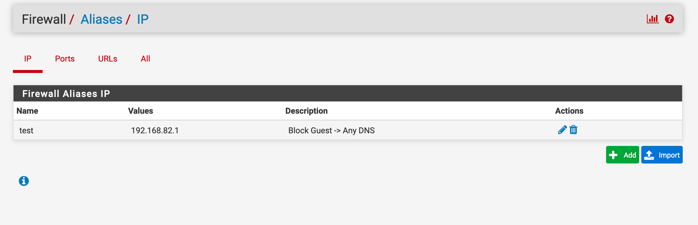

    Curious, I looked at one of our routers. Out of 22 IP aliases, mix of host and network, 15 show in diagnostics/tables. When creating a rule though, if you pick "single host or alias" then you can type in the Source Address field to the right and it should dynamically show you matching aliases. Even ones not on the diagnostics page show there for me. They don't show in a dropdown.
