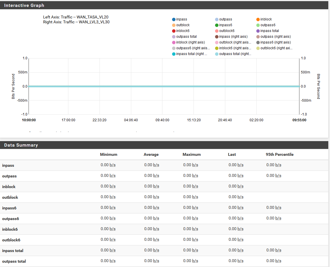

  • Status / Monitoring does not show anything
    736 Views
    _neok_
    @chrismacmahon Thank you for answering.
    I'd already done it. But just to confirm, I installed a new Opera browser and tried. Same issue . Definitely a pfSense problem. I just don't know how to track it.
    Could it be that there is some process or scheduled task that collects that data that is failing?

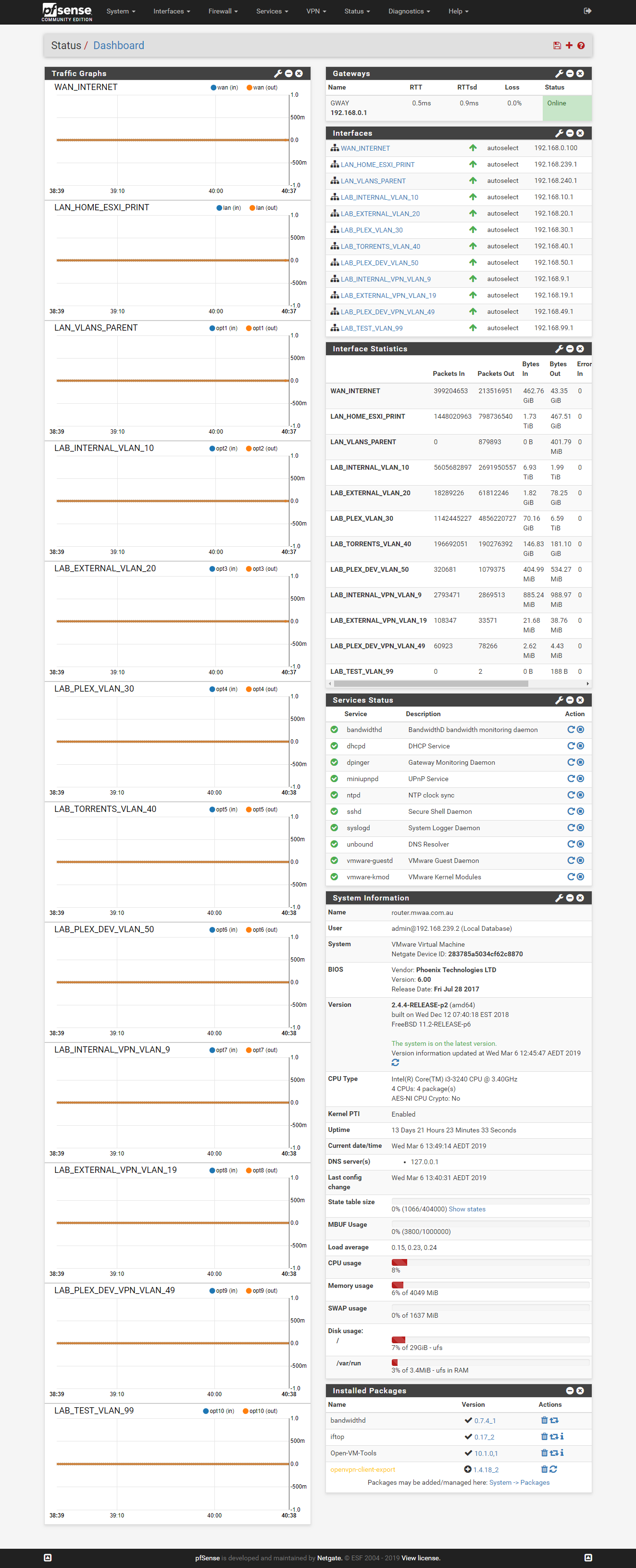

  • Setting issue or bug?
    Thank god i found out this thread :)
    I was thinking, that something is wrong with my custom pfSense box, but i can confirm, that this issues still resides.
    If I started a download in Firefox and then used the same Firefox browser to view the dashboard for the traffic graphs - the download would slow down a lot. When i view the dashboard from Chrome, no problem with speed.
    using: 2.4.4-RELEASE-p1 (amd64)
    built on Mon Nov 26 11:40:26 EST 2018
    FreeBSD 11.2-RELEASE-p4
    EDIT: with the latest Firefox 64.0 version, the issue is gone!
