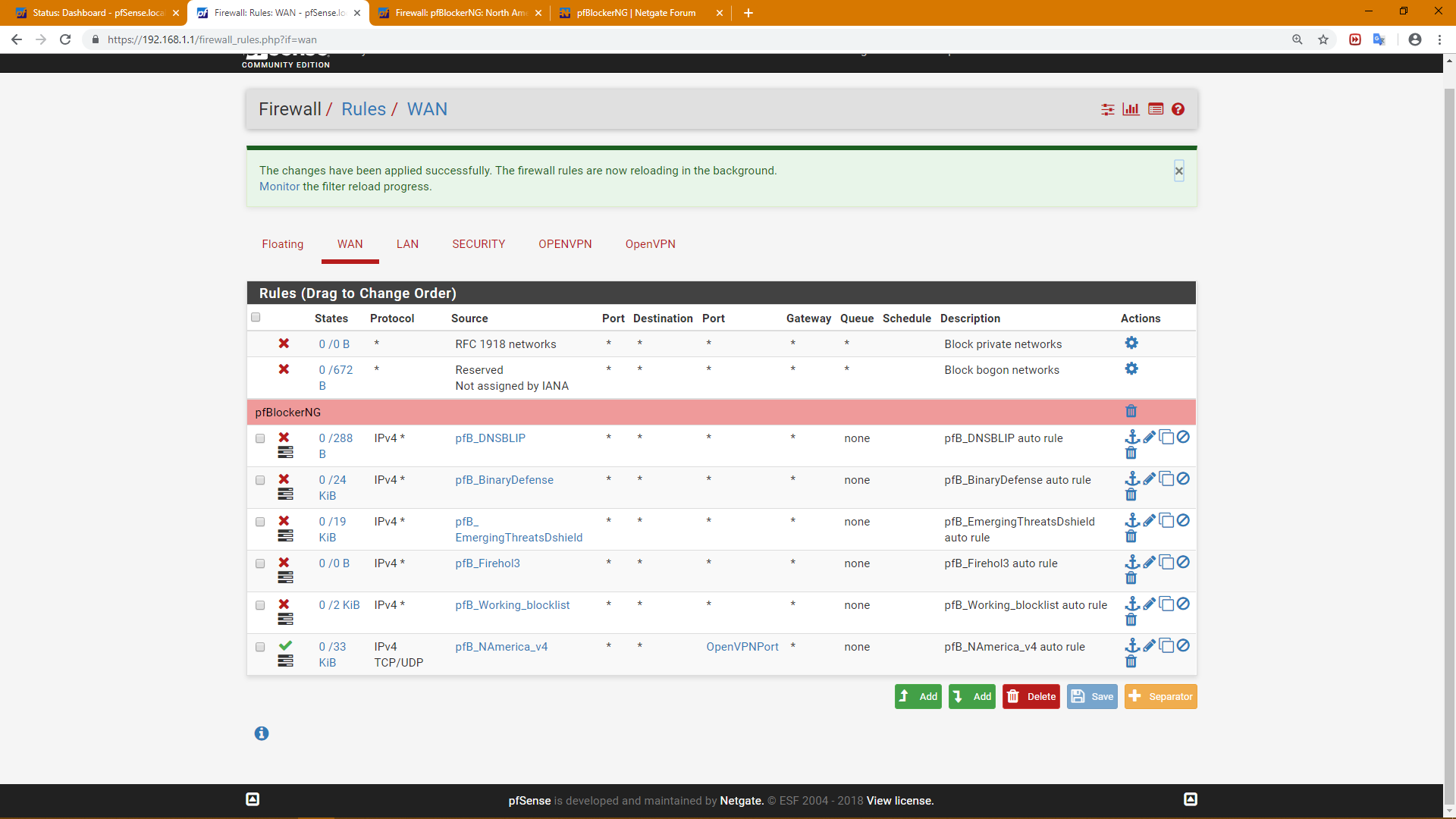

  • again: pfB is re-ordering rules
    365 Views
    RonpfSR
    In the Firewall / pfBlockerNG / IP there is the Firewall 'Auto' Rule Order settings you can configure.
    If the settings doesn't fit you needs, then you need to create your own rules.
