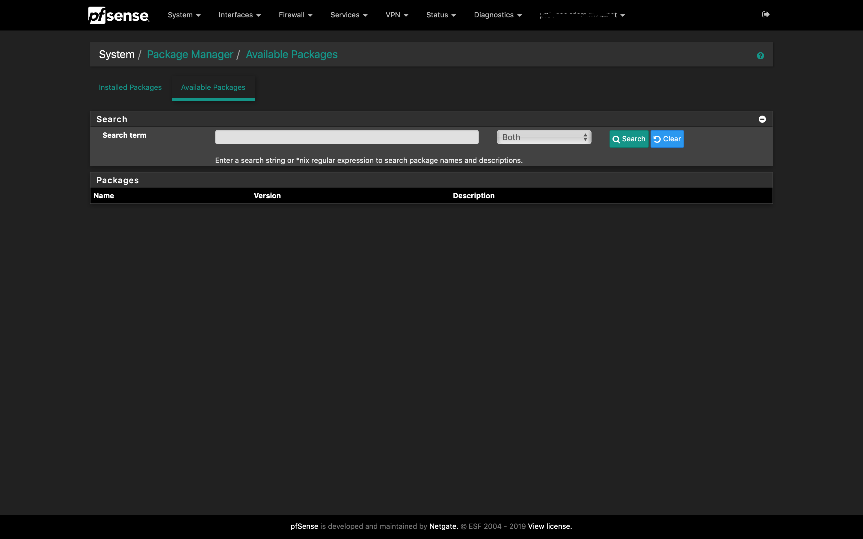

  • (SOLVED) no repo package load error :acces repo
    major501M
    i fix my problem when i leave wan in dhcp i can have package list and update and i can ping !!! [image: QsBXPNd.png] thank you for your help
