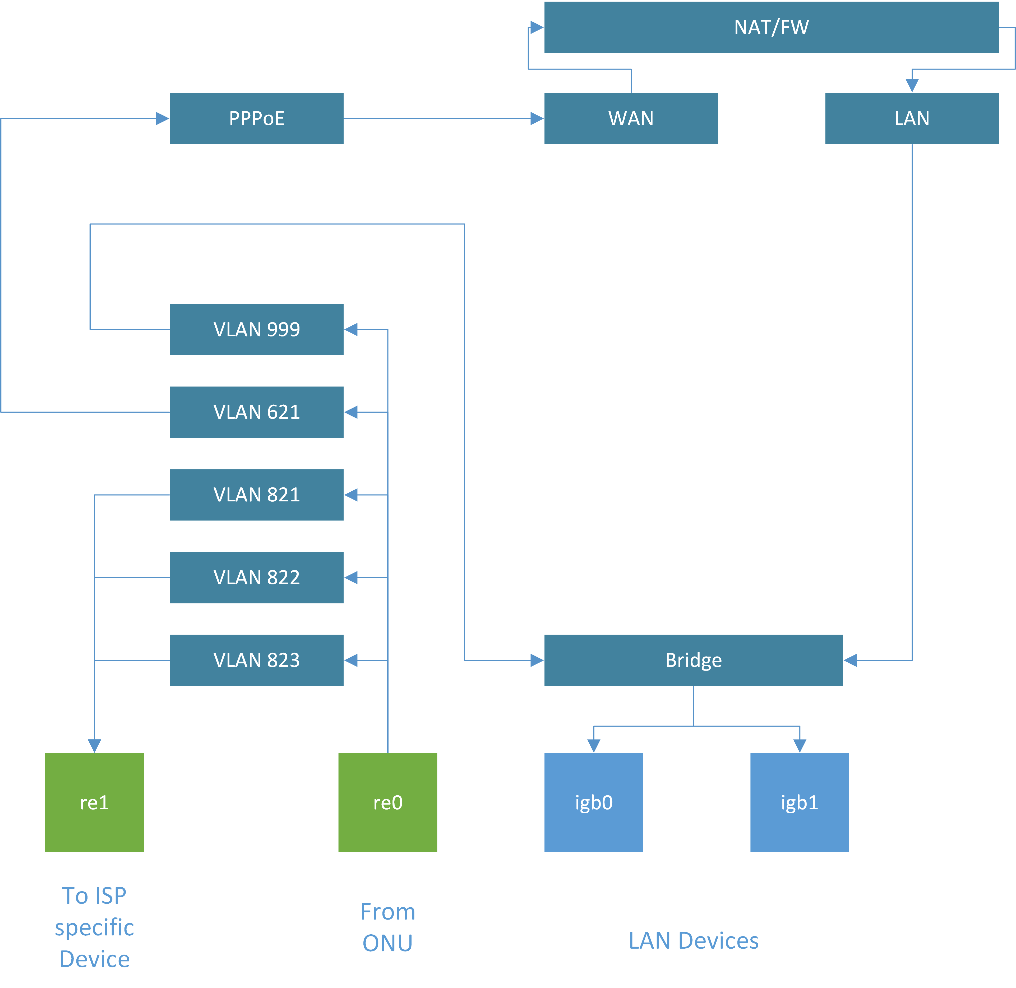

  • VLAN to VLAN Bridge (re0 to re1)
    861 Views
    @Rai80 Alright, I go try
