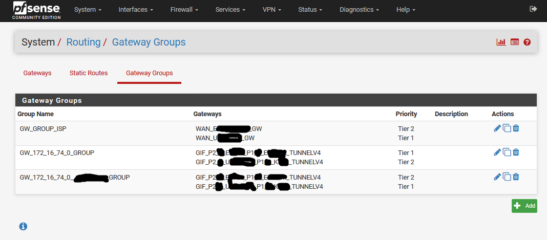

    @SergeCaron This is the result of a configuration error. Mine, of course! The "Disable Gateway Monitoring Action" option was checked on the Tier 1 Gateway on Box #1. Clearing this option, everything is working as expected on both boxes. Regards,

    @SergeCaron (Sheepish grin) I figured out the "cannot uninstall cleanly" caution in Patch Manager. I installed the patch and Patch Manager happily reports it can be uninstalled cleanly. Unfortunately, I can no longer reproduce the disapearing Gateway issue: even if I force a complete disconnect of Tier 1, the Gateway Group does not switch to Tier 2. So, I will close this issue for now.
