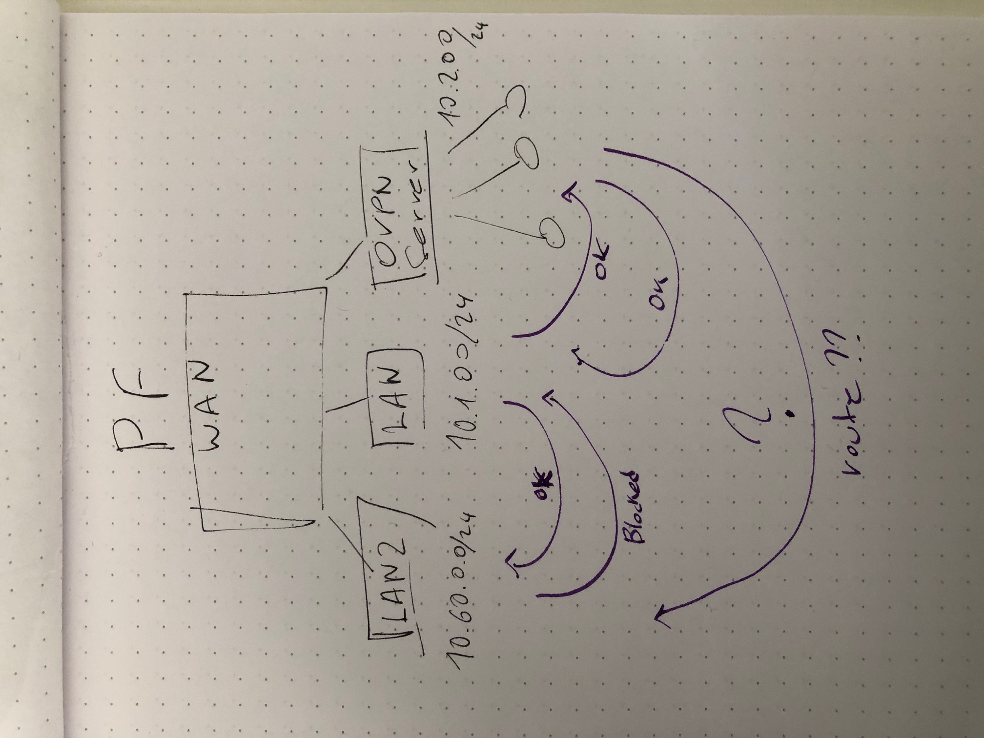

  • routing from staffwlan to 2 IP's in LAN1
    Firewalling routing firewall
    That'll do it!

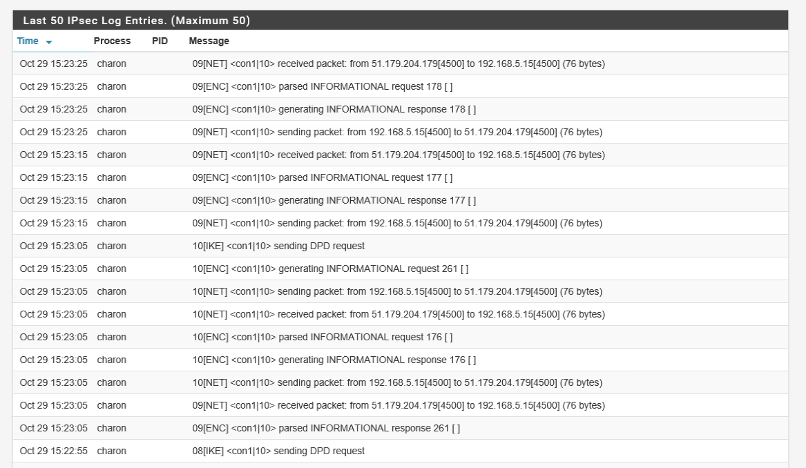

  • IPSec VPN Routing Issue
    IPsec ipsec routing
    833 Views
    2.3.2... I just don't get this.. Why would you not be on at least 2.3.5p2? 2.3.2 is no longer supported.. And to be honest the 2.3.x line is EOL here soon.. Like tmrw ;) https://www.netgate.com/blog/pfsense-release-2-3-x-eol-reminder.html
